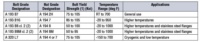

Table 1 shows the designations for bolt and nut grades shown in ASTM specifications that are frequently used in bolted flange assemblies.
Table 1
Table 1. ASTM Specifications for Specific Fastener and Nut Grades
Notes:
  1. Yield strength varies with fastener nominal diameter.
  2. Fastener A 193 B8 cl. 1 and A 193 B8M cl. 1 have lower yield strength than the cl. 2 listed in the table. This difference frequently is not recognized and has been the cause of failures.
