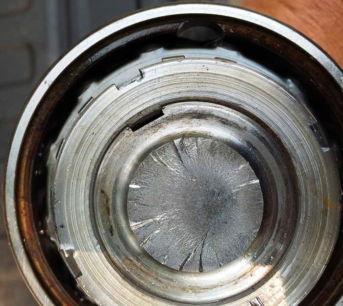

It seems that most pump owners/operators immediately blame the manufacturer if the pump shaft breaks. Yet in most cases, it is not the manufacturers’ fault. This article explores the issue and the potential causes. While many of these points are specific to centrifugal pumps, several apply to all rotating machinery, including turbines, compressors and motors. Credible pump manufacturers design their machine shafts for normal startup and operational factors, but some have higher margins for upset conditions and safety margins (think torque). The main reason that shafts break can often be traced to operational and system reasons. Fatigue failure (also known as failure due to reversed bending fatigue with rotation) is the most common cause of pump shaft fractures/failures.

Looking at the six most commonly used pump shaft materials reveals differences in hardness, strength and corrosion resistance. One point to note is the Young’s modulus for the materials almost all fit in the same range. The Young’s modulus is in essence the material’s elasticity—how many times can you bend it before it breaks? More important is how far can you bend it on each cycle before you exceed the material’s limits? Young’s modulus should not be confused with strength, toughness or hardness. Since the most common shaft materials all have a similar Young’s modulus, the decision to change materials is rarely the single solution to correcting the root cause of shaft failure. End users will experience higher reliability by addressing the other operational factors. The most common cause of shaft breakage is (rotational) tensile bending fatigue. These fracture types are a result of the bending stresses previously mentioned. For a given material, the number of cycles and, to some degree, the periodicity (frequency) and the distance (strain or amplitude) of the bending cycle will determine how long the shaft will remain as one piece. The fault initiates at the weakest point, which is typically a radius, fillet or keyway. The fault may also occur at a bending moment point. For the most common pump shaft materials, the fractures from bending stresses will occur at right angles (90 degrees) to the shaft centerline, so these failures appear almost as if the shaft snapped off or was cut off at that failure point. A less frequent mode of failure is fatigue from torsional stresses where the fracture occurs at a 45-degree angle to the shaft centerline. Torsional failures have increased with the advent of variable speed devices.References

- Operating Away from BEP: Departure from operating in the allowable region of the pump’s BEP is likely the most common cause of shaft failure. Operation away from BEP creates unbalanced hydraulic radial forces. The deflection of the shaft due to the radial forces creates a bending force that will occur twice per shaft revolution. For example, a shaft rotating at 3,550 revolutions per minute (rpm) will bend 7,100 times per minute. This bending dynamic creates a shaft tensile bending fatigue. Most shafts can handle the high number of cycles if the amplitude (strain) of the deflection is low enough.
- Bent Shaft: Bent shaft issues follow the same logic as a deflecting shaft referenced above. Purchase pumps and spare shafts from manufacturers that have high standards/specifications for shaft straightness. Due diligence would be prudent. Most tolerances for pump shafts are in the 0.001- to 0.002-inch range with the measurement as total indicator readout (TIR).
- Unbalanced Impeller or Rotor: An unbalanced impeller will create “shaft whip” while in operation. The effect is the same as if the shaft was bent and/or deflected, even though the shaft would measure straight if you stopped the pump and checked the shaft. It could be argued that balancing the impeller is just as important for slower-speed pumps as faster-speed pumps. The number of bending cycles in a given time frame is reduced, but the amplitude (strain) of displacement (due to the imbalance) remains in the same range as the higher-speed factors.
