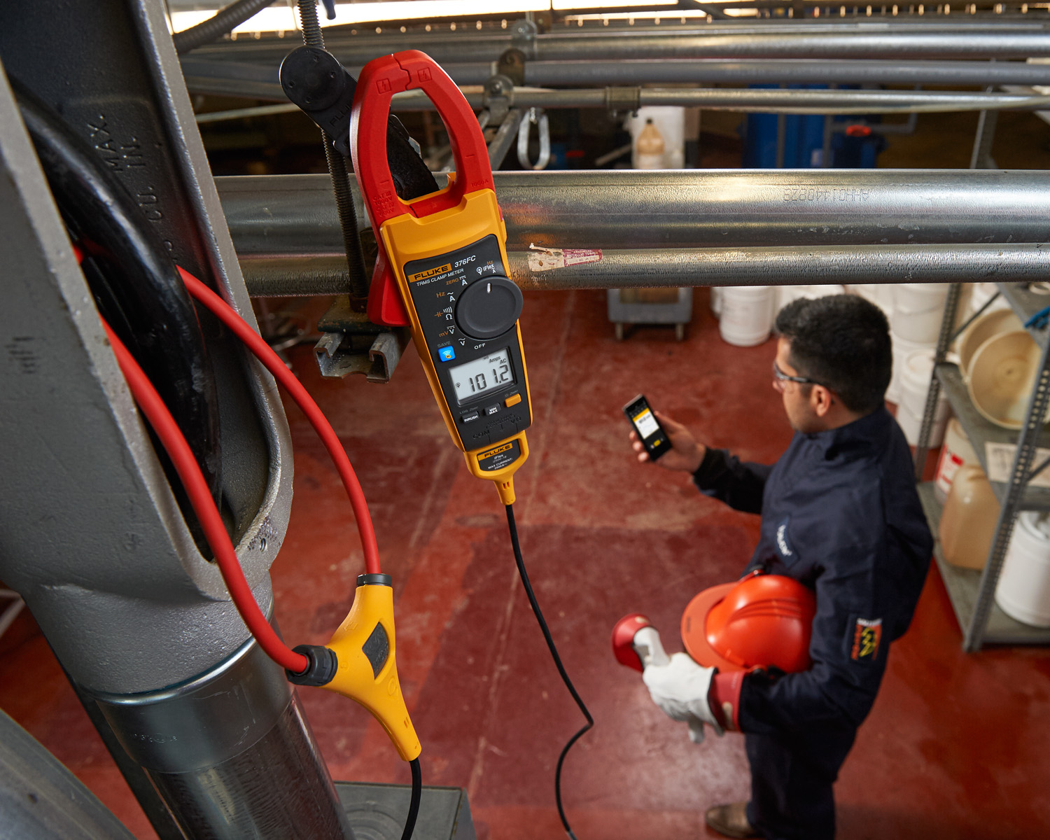

Take the time to put on the proper personal protection equipment (PPE) for the job—follow the table method to see what level of gear is needed based on the National Fire Protection Association (NFPA) 70E Standard for Electrical Safety in the Workplace. Remember that wearing PPE rated for a higher hazard level than the environment calls for will not necessarily make users safer. Having the right PPE for the job is crucial—Class 2 electrical gloves are not necessary if a user never gets into equipment over 480 volts, for example. Thick gloves can reduce dexterity, which may cause users to drop a tool or a test lead when working with an energized panel.
In addition to choosing the right PPE, select handheld test tools are designed to be easier to operate with heavy gloves. It is also possible to reduce the amount of PPE required in some instances by equipping workers with noncontact tools, such as thermal imagers, infrared (IR) thermometers and wireless or remote tools that allow workers to capture data from outside the arc flash zone—which increases overall safety.
Once appropriately geared up, match the measurement category (CAT) rating of the test tool and test leads to the work ahead, and check that the tool and its accessories are safe to use. Today’s safety standards require some electrical tools to include special high-energy fuses designed to keep the energy generated by an electrical short inside the fuse enclosure, protecting the user from electric shock and burns. When it is time to replace fuses, always choose the high-energy fuses approved by the meter’s manufacturer; cheap generic replacement fuses can increase the risk of serious injury.
Matching the tool to the job also means replacing outdated equipment. The safety features in today’s test tools were unheard of even a few years ago; even if “old reliable” is still working, the new safety and test features can be well worth the cost of an upgrade.
Use lockout/tagout when necessary. Follow the steps in NFPA 70E to remove power from an electrical circuit or panel and lock out and tag the panel or circuit so that no one can re-energize it while work is in progress. In situations where it is not feasible to shut down the power, follow the Occupational Safety and Health Administration (OSHA) rules for qualified electricians and technicians working on energized systems.
When working with live circuits, remember the old electrician’s trick: keep one hand in your pocket. It lessens the chance of a closed circuit across your chest and through your heart. Hang or rest the meter if possible; avoid holding it in your hand to minimize exposure to transient charges.
