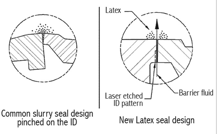

Latex
Liquid synthetic latex is an emulsion of polymer particles suspended in an aqueous solution. It is used in making coatings, glues and gloves and more.![image 1 stages latex](/sites/default/files/0119/SS0119-image-1.jpg)
![image 2 convex faces](/sites/default/files/0119/SS0119-image-2.jpg)
![image 3 latex accumulating](/sites/default/files/0119/SS0119-image-3.jpg)
![image 4 comparison between common slurry](/sites/default/files/0119/SS0119-image-4.jpg)
- increased operational cost due to the continuous supply of external flush
- dilution of the final product, as water is usually used as a compatible external flush
- external flush remains active at all times, even when the seal is static
- seal performance dependent on the reliability of the Plan 32
- seal usually fails once the bushing or lip seal separating the Plan 32 flush from the inboard seal wears out
