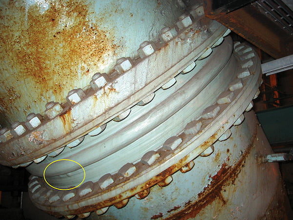

Image 1. Inspection of REJ body blister as a failure mode (Image and graphic courtesy of FSA)Image 1. Inspection of REJ body blister as a failure mode (Image and graphic courtesy of FSA)

Through traditional preventive maintenance techniques such as dimensional verification and visual and physical inspections, end users and technicians can predict failures before they pose a serious threat to the plant. Dimensional verification is critical for understanding current stresses in the joint and ordering an optimal replacement part. The lower the stress the REJ is under, the longer its useful life will be. As mentioned above, ordering a joint to the field dimensions will ensure longer useful life of the part and lower stresses on the piping and equipment. Visual and physical inspections are critical to reveal the effects of aging and joint degradation. For example, aging rubber will be hard and brittle to the touch, often showing cover cracking. Blisters indicate the tube has been compromised and fluid is wicking through the fabric reinforcement layers. In some dramatic cases, ballooning is observable; this would indicate that a significant number of the fabric reinforcement plies have been compromised, and failure is imminent. Performance replacement REJs and traditional inspection methods are the primary benefits of a plant reliability and efficiency program offered by a qualified REJ manufacturer. Such a program provides direct training and support and is MRO-focused. Additionally, it can avoid catastrophic system failures, reduce U.S. Environmental Protection Agency liabilities and negative news cycles, and increase overall plant safety factors. Industry best practices have shown the importance of on-site training and inspection services, technical resources, and a transparent relationship with the REJ manufacturer.

FMEA programs are well-documented and recognized as effective reliability tools. They quantify process failure risks by considering their causes, effects and failure modes. Additionally, they provide a risk-priority number based on severity of failure, likelihood of occurrence and ability to detect. A qualified REJ manufacturer can recommend corrective actions and timelines to significantly reduce the identified system risks and corresponding risk-priority numbers. The manufacturer also should have a comprehensive failure assessment table for the design, installation, operation and retrofit phases of REJ applications. Example REJ failure modes include cracking, delamination, blisters, ballooning and leaking flanges. An REJ experiencing body blisters as a result of a compromised tube, for example, would have a high risk-priority number based on the difficulty to detect, severity of the failure and the relatively high likelihood of failure occurrence. Corrective actions can be taken at the next scheduled outage and should include using a performance replacement REJ. This will minimize the risk-priority numbers associated with the severity of failure and the likelihood of occurrence. Implementing traditional and advanced inspection methods also will reduce the risk-priority number associated with the ability to detect the failure mode. REJ programs can maximize plant reliability and efficiency, and allow the industry to confidently transition to condition-based maintenance with a predictable replacement cycle.
