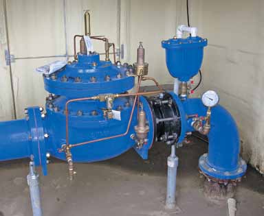

Figure 1. Double-diaphragm PRV in the heated enclosure

The solution was to develop a reliable interconnection between the Millcreek system and the Summit system, so that the Summit Township Water Authority's (STWA) existing Waterview water storage tank could automatically backfeed into the Millcreek system in the event of a fire or loss of electric power at MTWA's Peach Street station. A manually operated pressure reducing valve (PRV) had been installed years before to provide emergency backflow, but it was not 100 percent reliable.
In addition to being a single (non-redundant) device, the valve was located in a buried vault. Its activation required an operator to be present to open a gate valve. With a pressure differential of about 100 psi at the interconnection point, an automatically operated, fail-safe PRV was needed to avoid damage in the event of valve failure. Installing two PRVs as a safety backup was considered as a safety backup, but that would add cost and double the maintenance required. A pressure reducing valve with integral backup (PR-SM), was the best solution. The new control valves have a second and independent operating system superimposed upon the standard primary system. Under normal pressure reducing conditions, the primary pilot senses the downstream pressure through a connection at the valve outlet. Under flowing conditions, the pilot reacts to small changes in pressure to control the valve position by modulating the pressure above the diaphragm in the lower operating chamber. The downstream pressure is steadily maintained at the pilot set point that is adjustable.
Should the primary pilot system and/or main valve fail to control the downstream pressure, the independent back-up pilot system will begin to operate. It controls the pressure above the diaphragm in the second operating chamber. The back-up pilot is set slightly higher than the primary pilot. The forces now operating in the top chamber assume control of the inner valve assembly and maintain pressure reducing control.
The secondary pilot continually senses the downstream pressure. Should there be a rapid rise in downstream pressure, the secondary pilot will respond quickly and pressurize the top chamber. This will complement the primary pressure reducing controls and provide faster response. The installation took about two weeks to complete once the materials were on hand.
